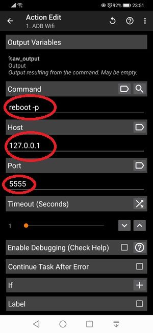

@lucians  schrieb:
I've used Tasker to make an APK that shuts down the TV but I'm reluctant to share it since no one should install random apks from strangers.
The app works by creating an ADB debug connection to itself (via the loopback interface) and uses the higher privilege "shell" user to run "reboot -p", the shutdown command.
However, this is how I made it.
On your TV:
-enable Developer mode
-enable ADB Debugging
The apk will have to be done on a smartphone since on the Android TV  Tasker malfunctions.
Install Tasker and Tasker App Factory
https://play.google.com/store/apps/details?id=net.dinglisch.android.taskerm
https://play.google.com/store/apps/details?id=net.dinglisch.android.appfactory
Create a Task and add an "ADB Wifi" Action like the one below
You need to use the  "back" button to save it (no, I don't get the logic either)
You also need to select an icon for the task.
Then in the task list you long press the task and from the 3 dots menu (upper right) you select Export -> As app
app name can be something like "com.notsony.poweroff"
You'll find the apk with a Files/Explorer app in this location: "internal storage/Tasker/factory/kids"
The apk won't create a shortcut on Android TV, for that you'll need to load in on this website: http://atvlauncher.trekgonewild.de/index.php
You also need to pick an icon (banner is optional).
Now, in Android TV, you must sideload both the apk from Tasker and the Shortcut apk from the website  (eg with ADB or if you have Total Commander installed :P)
Does this really work for you, or is it just theory?
I've tried the adb reboot -p command from my computer, but it didn't work. The TV shuts down for some seconds and then reboots automatically. It's exactly the same behaviour as pressing the power button for about 7 seconds.
If I could get this working I might write an app which shuts down the TV by long pressing the power button.
Edit:
I just found another way to turn off the device programmatically :slight_smile:
It's more hacky and thus less reliable, but at least it doesn't depend on developer settings.
But I'm still curious, how did you get reboot -p working?
