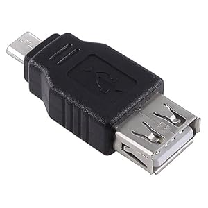

I cannot guarantee it will work with the Hub. I tried with this adapter but it didn't work, even with the USB Hub connected to the Wall. Weird, but the usbotg service was running.
Anyway, here's a link if you want a USB Hub with external power.
Edit: I just saw that you're having a Power Consumption Error, i should work if the Hub can provide power. Mine doesn't even recognize any USB Drives with the adapter. Oh and i tried with an Xperia P, not an S.
