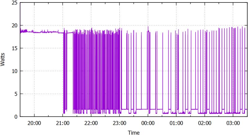

I started to measure power consumption in standby with an EdiMax SP-2101W and FHEM software.
First test I have done is with optimized settings like:
Remote start: disabled
Automatic software downloading: disabled
There are easily 50-100 wake-ups per night which might sooner or later upset the PSU.
At least with those optimized settings, it went to deep sleep for the first time about half an hour after switching off the set (going from ~20W to 0.5W).
This test was done with the antenna cable unplugged. It might very well be that the TV therefore fails to update the EPG/services, retrying every X minutes.
@Anonymous @Peter_S. Maybe you guys can find something out about Sony standby behavior? That does not look too healthy...
Next night I will try with antenna cable plugged in.

With signal cable plugged in, the picture changed only slightly. The TV went into deep sleep a bit later. It could perform the EPG/service update this time. Still it woke up every few minutes.

It gets even worse. This is what it looks like after enabling Remote start:
Right until 23:00, the TV kept going to sleep and waking up every few seconds without the user noticing anything. So what happens at 23:00... well... my Synology NAS is being switched off for the night. Some network traffic indeed prevents the TV from staying asleep. I wonder how long the TV can survive that and how many broken power supplies suffered from this issue...
But even with Remote start being disabled, the TV keeps waking up every few minutes in my network, also with the Synology NAS being switched off. So there still seems some traffic that wakes the TV up which stops after unplugging the LAN cable and switching off Wi-Fi.

It was the ZeroConf protocols (Bonjour/SSDP) on my NAS which caused this huge mess. The problem is not solved though. In the IoT era you might have some devices in your home which announce their services over ZeroConf. And even after disabling the services on my NAS, the TV still woke up every few minutes, even with Remote start being disabled, which is totally not acceptable!!!
Remote start on (Bonjour/SSDP enabled on NAS until 23:00):
Remote start on (Bonjour/SSDP disabled on NAS):
Remote start off:
