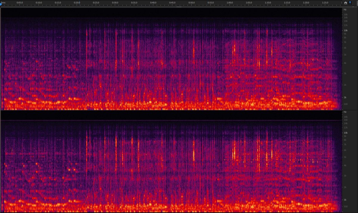

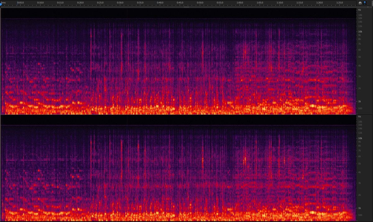

Hi Ben and Philippe,
I just managed to have a look at the results myself. I admit that despite my initial scepticism the issue had made me very curious too. Let me give you a brief summary on how the test was performed.
First the FSS (Frequency Spectral Signature) of the 4 different calibration types (Off, Front Reference, Engineer & Full Flat) was captured after a full factory reset and a D.C.A.C. EX (5.1 sound calibration) performed with A.P.M. enabled. So all other specific device settings (DSD Native, D.L.L., EQ, etc.) were left at their respective factory reset default values. The FSS captures belong to a sample source of about 1 minute and 30 seconds of a Netflix 5.1 48 kHz title which was delivered from a TV connected by HDMI ARC. On the vertical axis of each FSS you see the frequencies ranging from about 100 Hz to 16 kHz and on the horizontal axis the timestamp is registered. The brighter the color in the FSS the higher the frequency response level measured in dB.
Fig 1: Frequency Spectral Signature for Calibration Type: OFFFig 1: Frequency Spectral Signature for Calibration Type: OFF
Fig 2: Frequency Spectral Signature for Calibration Type: Front ReferenceFig 2: Frequency Spectral Signature for Calibration Type: Front Reference
Fig 3: Frequency Spectral Signature for Calibration Type: EngineerFig 3: Frequency Spectral Signature for Calibration Type: Engineer
Fig 4: Frequency Spectral Signature for Calibration Type: Full FlatFig 4: Frequency Spectral Signature for Calibration Type: Full Flat
Once the reference signatures were captured for all 4 calibration types, the steps to replicate the fault were performed according to your description and an FSS was captured to compare the signature with that of the 4 reference signatures.
Now the following FSS captured in Fig. 5 is the result of when the calibration type was left to Full Flat prior to powering OFF and ON the TV. The FSS of Fig. 6 belongs to the result of when the calibration type was left to Full Flat prior to disconnecting and reconnecting the mains to the AVR after 1 minute.
Fig 5: Frequency Spectral Signature post power cyclcing the TV with calibration type left to Full Flat in advanceFig 5: Frequency Spectral Signature post power cyclcing the TV with calibration type left to Full Flat in advance
Fig 6: Frequency Spectral Signature post disconnecting and reconnecting the mains only to the AVR after 1 minute with calibration type left to Full Flat in advanceFig 6: Frequency Spectral Signature post disconnecting and reconnecting the mains only to the AVR after 1 minute with calibration type left to Full Flat in advance
I recommend you first download the figures to your desktop and then make a close side-by-side comparison. The first aspect you will immediately notice is that Fig. 5 and 6 have technically the same FSS. I invite you then to take a closer look at either Fig. 5 or 6 and compare it to Fig. 4 which is the FSS for calibration type Full Flat.
  • You should be able to notice the bright spots occurring at about timestamp 0:50.0 & 1:00.0 for the 5 kHz to 6 kHz range. These are characteristic for all three figures 5, 6 and 4. You don't see these bright spots in Fig. 1 where the calibration type is set to OFF.
  • You should also be able to notice that the frequency response level for the range between 100 Hz and 500 Hz is much more pronounced for the entire length of the sample on Fig. 1 compared to that of Fig. 5, 6 and 4.
In fact all 3 calibration types other than OFF try to expand and evenly spread the frequency response levels across a wider range of frequencies. Anyone can tell from analysing the figures that the Full Flat calibration type is maintained post a power cycle or mains reconnection of the receiver.

Just bear in mind that all the digital sound processing features are integrated into groups of microprocessors on the AVR, therefor it is technically impossible for the device to have only one single malfunction on this particular process while no other features are affected. So if hypothetically your device might be malfunctioning, the root cause would come down to its microcode software and not hardware since all other features are performing fine. But then again, it is impossible that the microcode software is performing differently on your device compared to all other devices. My personal opinion is that you still won't be convinced that the device is functioning properly even after a service repair.
In response to your question of performing a test yourself at home, I certainly think that that should be possible. Indeed all you need is a quiet environment and a mobile phone. I am sure you could search for a frequency spectral analysis app or at least only do the sound recording with an app then perform the analysis on a desktop. Which ever sound sample you choose does not make much of a difference as long as you use the exact sample for each recording.
Let us know your thoughts!
Cheers,
Dutchice
