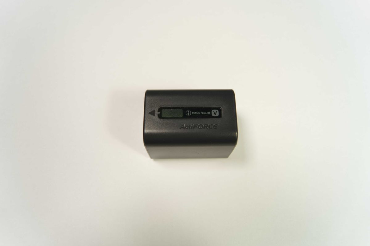

I made some test shots with the same settings on my a57 camera, just to illustrate what I mean (all settings match except the aperture, since I can't match it with the lens I use).
Canon equivalent:
Canon PowerShot G11 equivalentSony equivalent:
Sony DSC-HX60 equivalentI hope I didn't make any mistake while thinking about it, yet to me it doesn't make sense, why the DSC-HX60s image comes out much darker.
