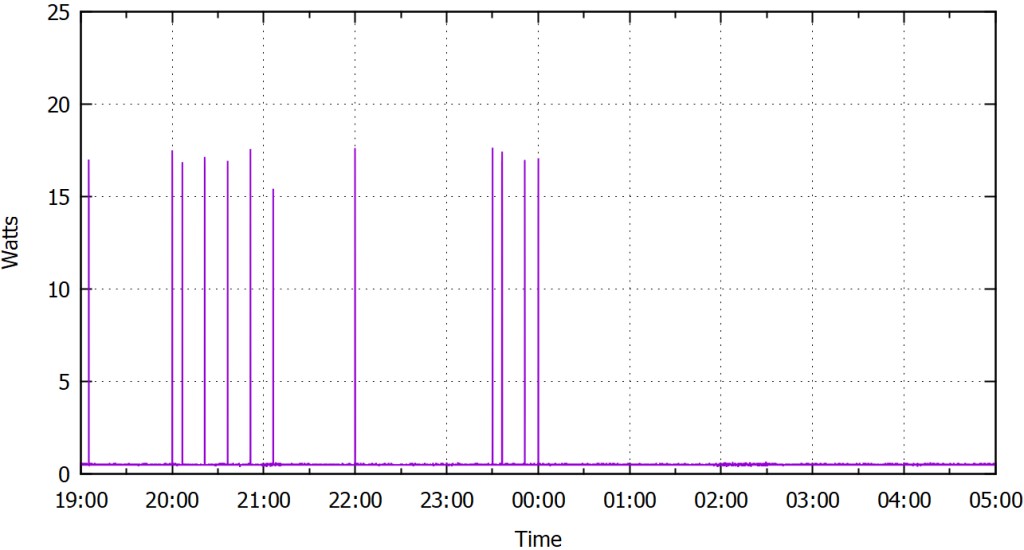

I started to measure power consumption in standby with an EdiMax SP-2101W and FHEM software.
First test I have done is with optimized settings like:
Remote start: disabled
Automatic software downloading: disabled
There are easily 50-100 wake-ups per night which might sooner or later upset the PSU.
At least with those optimized settings, it went to deep sleep for the first time about half an hour after switching off the set (going from ~20W to 0.5W).
This test was done with the antenna cable unplugged. It might very well be that the TV therefore fails to update the EPG/services, retrying every X minutes.
@Anonymous @Peter_S. Maybe you guys can find something out about Sony standby behavior? That does not look too healthy...
Next night I will try with antenna cable plugged in.

Here is another night with WiFi being disabled on the Sony:
You can clearly see that wake-ups happen way less often for me now. Manually disabling/enabling WiFi is of course no solution!

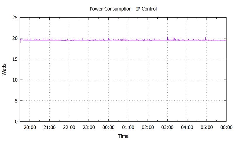

@Jecht_Sin
I tried with IP Control tonight:
The TV did not go into deep sleep anymore. So better don't use or recommend this setting anymore...

WHAT?!?! 19-20W constant with IP Control on?!?! Are they mad or what? It's just an HTTP/TCP service! Sure the Ethernet interface doesn't go down anymore! And sorry for the many exclamation marks, but things like this drive me mad!!
I can't believe this (well, that's a figure of speech. I actually had a strong feeling that was the case). Turning it off now, I hate to throw energy in the toilet. Not to mention that my AVR has IP Control enabled as well and the apps I tested recognize the AVR, but obviously not the Bravia. Oh, the best app I've fpund (at least for the AVR) is Peel Remote if anyone is interested to try it. Maybe it works with Android 6.0.1.
