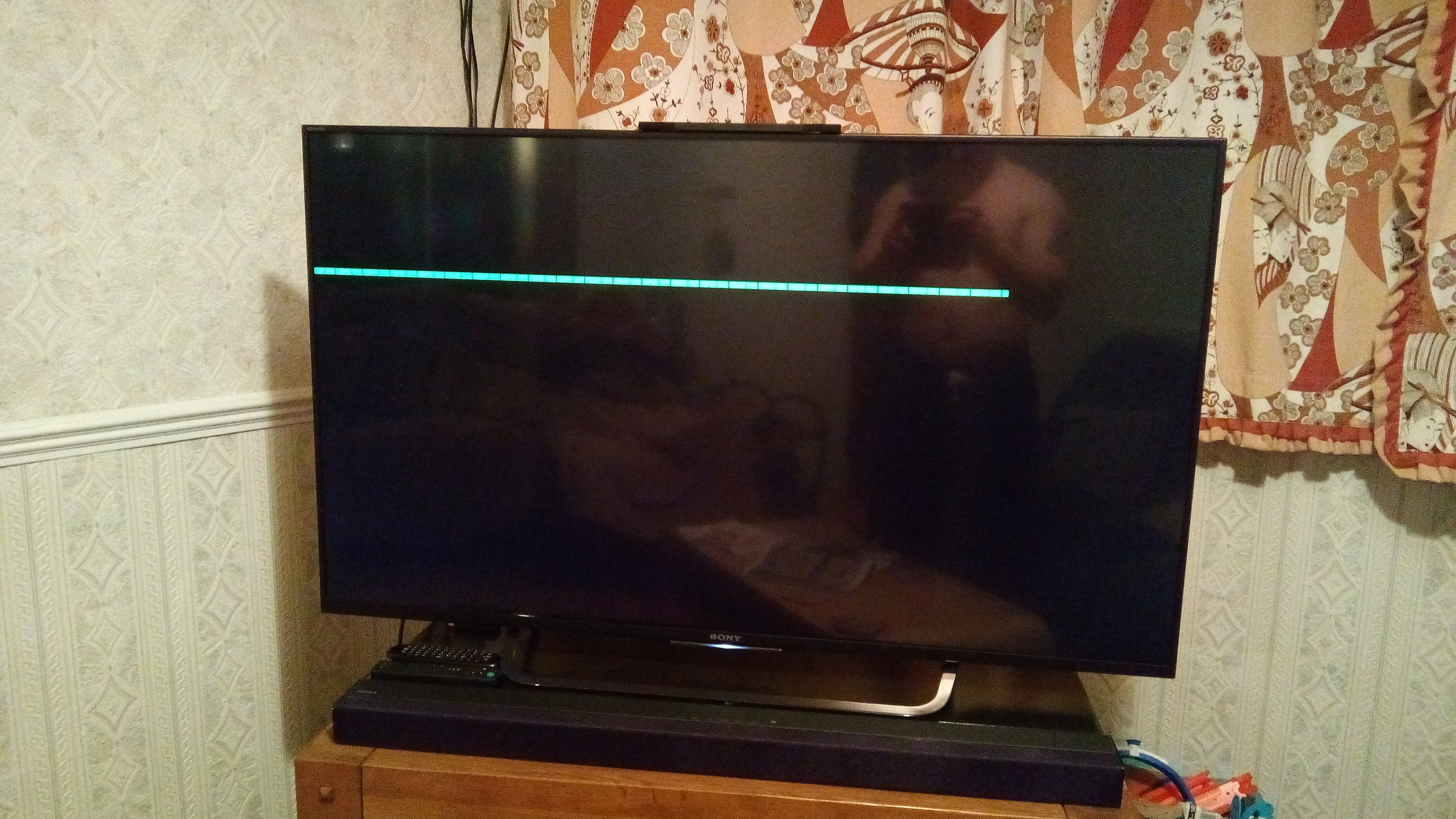

so no juddering so far since the last update and the video apps seem to be playing okay.
however...we just noticed a horizontal line, sort of dotted, along the screen. we initially thought it was the program but it stayed there when another program came on. we turned it off and on and it is gone for now but it never did this before the update.
bagahun
I've had the same on one occasion but prior to the update so not related to that. As with you a power cycle sorted it out.
marc.knuckle
i spoke too soon.
shortly after this problem my wife put on netflix...no video, only audio. turned off netflix and not even the sky program came up, just blank. after a complete turn off then on the same issue initially, no netflix video, but then green artifacts kept coming up and randomly it would show a frozen picture of the sky program from hdmi 1 in the background behind the artifacts.
i have more photos and video also
