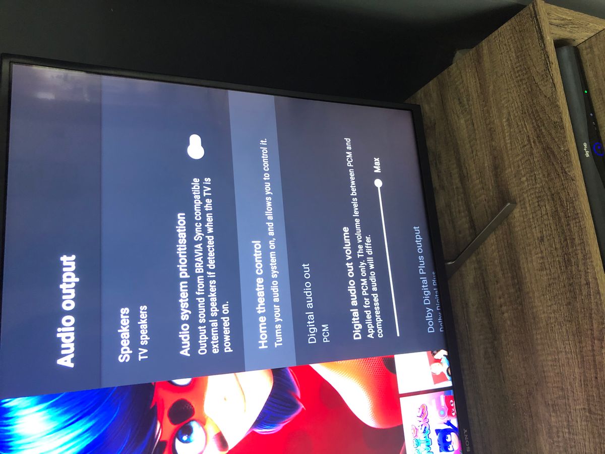

im trying to connect my sound system which uses a headphone socket, this previously worker with no problems on my old tv, but now I’m getting no sound. I can’t find any settings to enable the sound to come through that connection, the only think I can find is to direct sound through the tv speakers or sound system but when I select sound system no sound comes out.

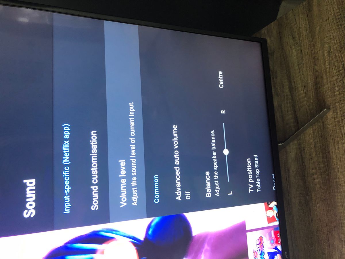

that setting is not on my tv, there is actually very little options in the sound sections
these are what I have:
And it’s only a 5 year old 2.1 pc speaker system, probably still better than most tv sound systems to this day
Hi @andy3050uk
The TV Speakers / Audio system is for HDMI connected devices.
What is under Sound customisation? There must be a setting somewhere to allow TV Speakers and Headphones at the same time or not.
Hi @LightFoot
under sound customisation is just to tweak the sound option for the app you are currently in.
I've searched everywhere, the option was simple on my old tv which had the old version of android gave you the option of tv speakers or headphones.
